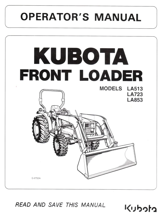

Kubota Front Loader Models LA513 LA723 LA853 Operator's Manual Printed in U.S.A. Code No. 7J266-6911-2 - Instruction Manual
