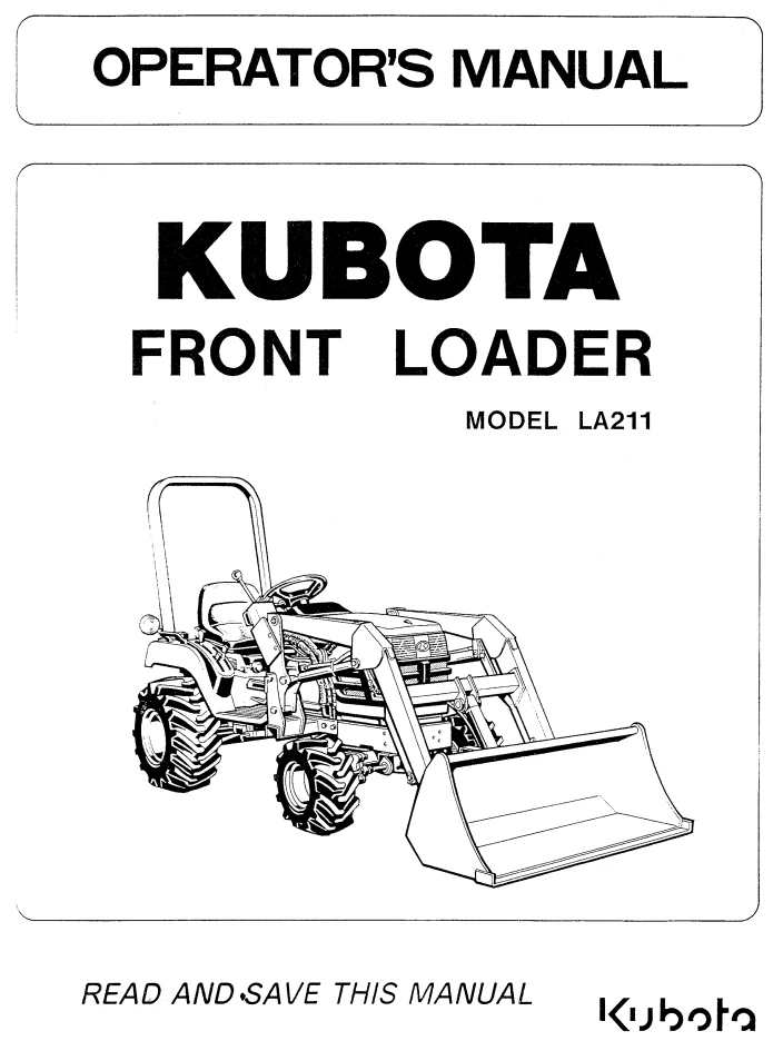

Kubota Front Loader Model LA 211 Operator's Manual Printed in U.S.A. English (U.S.A.) Code No. 75538-6911-2 - Instruction Manual
