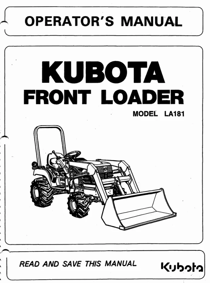

Kubota Front Loader Model LA 181 Operator's Manual Printed in U.S.A. February 2003 English (U.S.A.) Code No. 7J610-6911-1 - Instruction Manual
