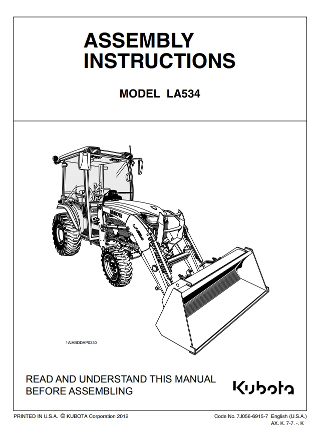

TO THE DEALER1. This manual contains procedures intended to assist the dealer in unpacking and assembling the product before delivering to the customer.The customer's purchase is based on confidence in both the product and your store. Observe the procedures in this manual to assemble and adjust equipment for your customer's safety and satisfaction. When fully assembled, check function of each part and feature. 2. The following safety alert symbol marks and indications are found throughout this manual in steps where particular attention is required so as to ensure your safety and to avoid product damage. Observe the instructions in these warnings where indicated.SAFETYTo prevent accidents, read through the following items before starting work, and always regard safety when working. It is your responsibility to ensure your safety onthe job.1. Preparations(1) Select a work site which is level, has sufficientspace, and is not close to dangerous objects.(2) Avoid poorly ventilatedrooms.Asphyxiation from exhaust fumes is always a possibility that accompanies running anengine.(3) Working clothes which maybe pinched or caught in theequipment must not be worn.Loose clothing can cause serious injury or death.(4) Always wear a mask andprotective goggles duringwork when dust or flyingdebris may be thrown byequipment.2. Assembly and adjustments(1) Before assembling equipment, read theassembly instructions for theproduct to become familiarwith the equipment andprocedures.(2) Use only adequate andrequired equipment, toolsand instruments (e.g. torquewrench, battery hydrometerand etc.).(3) Set the parking brake andblock wheels to preventmachine (or tractor)movement.(4) Lower the attachment orimplement to the groundbefore assembling oradjusting equipment.(5) Before working undersuspended or raisedequipment, support theequipment or attachmentand utilize the valve lock toprevent the machine fromfalling or moving out of place.(6) Keep fire from cigarettes,matches or other ignitionsources away from fuel, oil,antifreeze and otherflammable materials.
