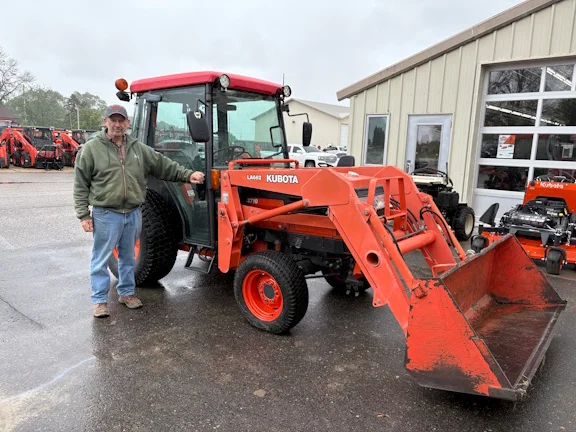

I purchased a 3710 with a full cab, loader, and snow blower. It has 1100 hours on it and runs great but the steering is very loose.
I kind of herd it down the driveway. I checked the tie rods and they are tight. Could air in the hydraulic steering be the problem
or is there an adjustment that can be made somewhere?
