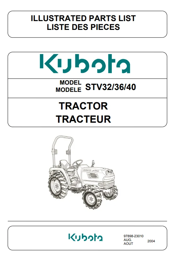

Kubota Tractor Models STV32/36/40 Illustrated Parts List 97898-23010 August 2004 AOUT - Intruction Manual
0 Fig . No. Represents No. corresponding to each group name.Specifications . The types and destinations of sister models are indicated. These indications are(for sister models) given to tell their relevant pages in this book.The symbols, (FR) (UK) and (G) in the "REMARKS" column or "HEADING" showthe models as to the following types.(SYMBOL) (TYPE)(FR) . STV32(4WD)/STV36(4WD)/STV40(4WD) FRANCE SPEC.Components . The components of an assembly are identified by a bracket of dotted lines.® Point . Indicates that the parts is not sold independently.The assembly (Ref. No.050) containing the part needs to be ordered .REF. No. Reference numbers are assigned to parts in the illustration . The code number of apart in the illustration can be identified by referring to the same reference numberin the part list .Model name07 S. No . .(serial No.)Engine Serial No. Old Serial No.654321 . . . 6 digits ail in numerals .New Serial No.Y A 4321I .C. (interchangeability)Example-1 . .Example-2 . . . .Example-3 . REMARKS 1 .(UK) . STV32(4WD)/STV36(4WD)/STV40(4WD) UNITED KINGDOM SPEC.(G) - STV32(4WD)/STV36(4WD)/STV40(4WD) GERMANY SPEC.The name of the basic model is indicated in this column . Other applicable modelsare indicated on the "REMARKS" column (B.Indicates a group of serial numbers to which a design change is applied .Lower 4 digits in numerals .5th digit . . . Alphabetical letter (Month of manufacture) .Alphabetical letter A,B C,D E,F G,H J,K L,M N,P Q,R S,T U,V W,X YZMonth 1 2 3 4 5 6 7 8 9 10 11 126th digit . . . Alphabetical letter or numerals (Year of manufacture).Al habetical letter or numerals W X Y 1 2 3 4 5 6 7 8 9 A B CYear '98 '99 20001- 011- 021 - 031 - 041'051'061'071'081'09 '10 '11 '12Indicates the interchangeability of parts due to design change.<- indicates that a new part can replace an old part, but not vice versa .15800-0000-0 is applicable to the first serial number to S. No. 15000.15800-0000-2 is applicable to the first serial number and above.* indicates that the new and old parts are not interchangeable.15800-1000-0 is applicable to the first serial number to S. No. 15000.15800-1000-2 is applicable to S. No . 15001 and above.H indicates that the new and old parts are interchangeable. Both 15800-2000-0 and15830-2000-0 are applicable to the first serial number and above .In this column, enter other applicable model names, dimensions and other specialitems. The following symbols and abbreviations are used throughout this book.29*12.00-15 . . . Tire size sq .m . . . m2 sq .mm . . . mm2 cucu.m . . . m3 .mm . . . mm' D . . . Diameter L . . . Length​
