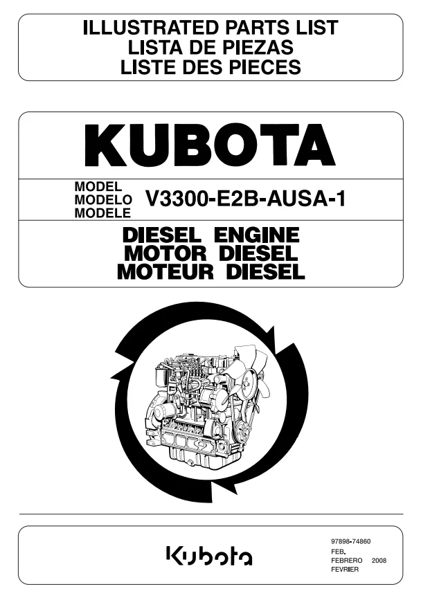

Kubota Diesel Engine Model V3300-E2B-AUSA-1 Illustrated Parts List Printed in Japan Feb. 2008 97898-74860 - Instruction Manual
1 Fig. No. Represents No. corresponding to each group name.2 Specifications...... (for sister models) The types and destinations of sister models are indicated. These indications are given to tell their relevant pages in this book.3 Components .........4 Point The components of an assembly are identified by a bracket of dotted lines. Indicates that the parts is not sold independently.5 REF. No.6 Model name........7 S. No.(serial No.) Engine Serial No.Z J 0001ZK A001The assembly (Ref.No.050) containing the part needs to be ordered. Reference numbers are assigned to parts in the illustration. The code number of apart in the illustration can be identified by referring to the same reference number in the parts list. The name of the basic model is indicated in this column. Other applicable models are indicated on the "REMARKS" column 9. Indicates a group of serial numbers to which a design change is applied. max Z999). Lower 4 digits in Numerals or Alphabetical letter (A to Z) and Numerals (start 0001 to 5th digit ...... Alphabetical letter (Month of manufacture). Month 1 2 3 4 5 6 7 8 6 10 11 12AB C.D E,F GH JK LM N.P QR S,T uv WX YZ6th digit ...... Numerals or Alphabetical letter (Year of manufacture). Year 1998 1999 2000 01 02 03 04 05 06 07 08 60 10 11W X Y 1 2 3 4 5 6 7 8 9 A B8 I. C............. (interchangeability) Indicates the interchangeability of parts due to design change. Example-1 ← indicates that a new part can replace an old part, but not vice versa.15800-0000-0 is applicable to the first serial number to S. No. 15000.15800-0000-2 is applicable to the first serial number and above. Example-2...... indicates that the new and old parts are not interchangeable.15800-1000-0 is applicable to the first serial number to S. No. 15000.15800-1000-2 is applicable to S. No. 15001 and above. Example-3 indicates that the new and old parts are interchangeable. Both 15800-2000-0 and15830-2000-0 are applicable to the first serial number and above. REMARKS 1.... In this column, enter other applicable model names, dimensions and other special items.00 REMARKS 2 The following expressions are used in NOTE for each group.Machines' serial numbers are indicated as follows.<=15000 ..... Serial number below 15000.>=15001 ..... Serial number above 15001.14000 to 15000 ..... Serial number 14000 to 15000.For some models, the above expressions may also be used REMARKS 1 9​
