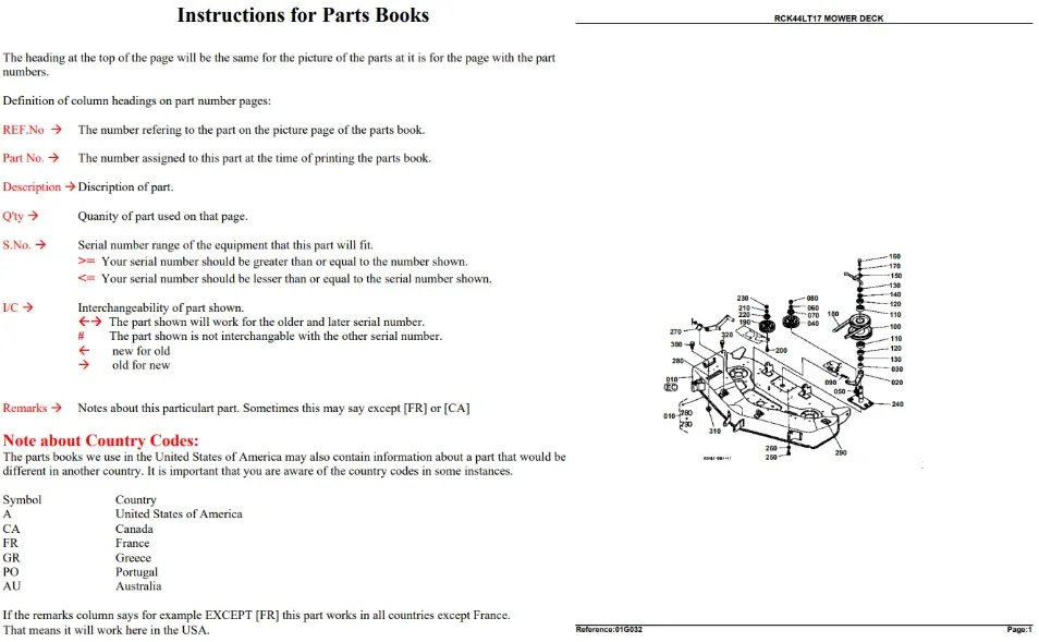

Ref.no Part No. Description Q'ty S.no. I/c Remarks Weight(Kgf)weight(Lb)010 K5142-97120 Kit Mower Deck 1 54 118.8010 K5142-71020 Kit Mower Deck (Ec) 1 <=42675 [ec] 0 0010 K5172-71020 Kit Mower Deck (Ec) 1 >=42676 ¬ [ec] 0 0020 K5142-71550 Arm Tension 1 0.41 0.902030 08511-02530 Bushing 1 0.03 0.066040 K5112-71650 Pulley Tension 1 (4.0) 0.53 1.166050 0y169-50628 Bolt Short Squ.necx 1 (3/8-24unf) 0.032 0.0704060 75599-33013 Washer Spring Lock 1 (3/8) 0.006 0.0132070 K5112-71660 Cover Tension 1 0.018 0.0396080 75599-31023 Hex.nut 1 (3/8-24unf) 0.006 0.0132090 K5142-72740 Spring Tension 1 0.09 0.198100 K5163-71240 Pulley 1 (5.5-7.25) 2.35 5.17110 08141-06205 Bearing 2 0.118 0.2596120 K5112-71282 Cover Bearing 2 0 0120 76516-61563 Cover Bearing 2 « 0.008 0.0176130 04612-00250 Circlip 2 (25) 0.002 0.0044140 K5112-71480 Washer Plain 1 0.006 0.0132150 K5112-71290 Retainer Belt 1 0.13 0.286160 01053-50818 Hex.bolt 1 (M8 X 1.25 X 18) 0.011 0.0242170 75599-33012 Washer Spring Lock 1 (5/16) 0.002 0.0044180 K5182-51310 V-belt 1 (69) 0.3 0.66190 K5112-71650 Pulley Tension 1 (4.0) 0.53 1.166200 0y169-50628 Bolt Short Squ.necx 1 (3/8-24unf) 0.032 0.0704210 75599-33013 Washer Spring Lock 1 (3/8) 0.006 0.0132220 K5112-71660 Cover Tension 1 0.018 0.0396230 75599-31023 Hex.nut 1 (3/8-24unf) 0.006 0.0132240 K5182-71710 Bracket Pulley 1 1.15 2.53250 01053-50818 Bolt Hex. 4 (M8 X 1.25 X 18l) 0.011 0.0242260 75599-33012 Washer Spring Lock 4 (5/16) 0.002 0.0044270 K5182-44350 Link 4 2 0.11 0.242280 K5112-73110 Label Danger 1 1 Except [ec] 0.002 0.0044280 K5113-73110 Label Danger 1 [ec] 0.003 0.0066290 K5112-73120 Label Danger 2 1 Except [ec] 0.001 0.0022300 01754-50814 Bolt Flange 3 >=30001 0.005 0.011310 02751-50080 Nut Flange 3 >=30001 0.006 0.0132
