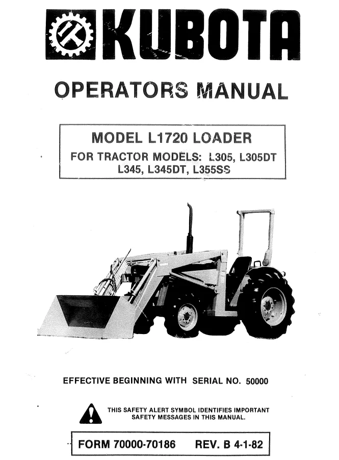

Kubota Model L1720 Loader for Tractor Models L305, L305DT, L345, L345DT, L355SS Form 70000-70186 Operator's Manual Rev. B 4-1-82 - Instruction Manual
These Specification Apply To Kubota L345dt Tractor And Loader Equipped With External (Opencenter-2000 Psi) Hydruallc Pump System; Front Tire Size 9.5-16; Rear Tire Size 13.6-28; And 66"Material Bucket Less Tines. Specifications Will Vary For Tractors And Loader Equipped Differently.(A) Maximum Lift Height. .113.5" (2883mm) (B) Clearance With Attachment Dumped89.75" (2280mm) (C) Reach At Maximum Height 39" (991mm)(D) Maximum Dump Angle.. 45° (E) Reach With Attachment On Ground..72.25" (1835mm)(F) Attachment Rollback Angle .170(G) Digging Depth. .7.5" (191mm)(H) Overall Height To Carry Position...60.25" (1530mm)break-away Capacity .2450 Lbs. (1110kg)lift Capacity At Full Height 1495 Lbs. (680kg)raising Time .4.3 Sec.*lowering Time 3.3 Sec.*attachment Dumping Time .3 Sec."Attachment Rollback Timeapprox. Shipping Weight(With Attachment)..2.5 Sec.*1433 Lbs. (651kg)*using External Hydraulic System@2800 Rpm. Tractor System Will Be Slower.2safetysafety Rulesyour Safety And The Safety Of Those Around You Is Dependent Upon The Care And Good Judgementyou Exercise In The Use Of This Equipment.read This Manual Thoroughly And Make Sure You Understand Its Contents. All Equipmenthas Limitations.the Safey Information Presented In This Manual Is Not Intended To Replace Safety Codes, Insurancerequirements, Federal, State And Local Laws, Rules And Regulations. Know The Regulations And Lawsthat Apply To Your Area And Be Sure That Your Loader Is Properly Equipped To Meet Such Laws Andregulations.we At Kubota Are Continuing To Contribute To Your Safety By Building Loaders With An Extrameasure Of Protection, And Passing On These Suggestions For Safer Operation.important: Always Replace Any Safety Decals Whenever The Old Decals Are Destroyed, Lost,painted Over Or Illegible. Replace All Safety Decals When Repainting​
