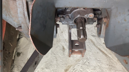

Hello, here's my dilemma and your advice is most welcome.
Kubota L4200DT GST 4wd. Independent pto system (hydraulic), not transmission based pto. Has this ol friend 28 years, not many problems til now
Now this issue is rear pto shaft lost it's mojo, only try to spins but can't. ( there is no mid-pto)
This issue started during last mowing session, and I did hit a big rock. Brushhog mower does has a slip clutch, yet I'm concerned after several years in this rainy place it's clutch has locked up and the damage has gone to the tractor pto system. Here's a vid of the pto shaft behavior. What do you think, internal pto clutch pack, shaft coupling, gear?
will try to upload a vid to show it's behavior.
