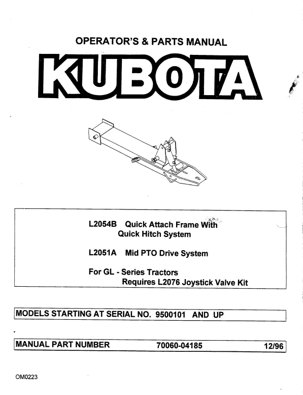

Kubota L2054B Quick Attach Frame with Quick Hitch and L2051A Mid PTO Drive System Operator's and Parts Manual S. 9500101 and Up, 70060-04185 12/1996
