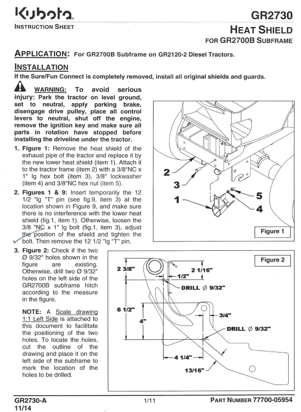

Kubota GR2730 Heat Shield for GR2700B Subframe Instruction Sheet PART NUMBER 77700-05954 - Instruction Manual
WARNING: To avoid seriousinjury: Park the tractor on level ground,set to neutral, apply parking brake,disengage drive pulley, place all controllevers to neutral, shut off the engine,remove the ignition key and make sure allparts in rotation have stopped beforeinstalling the driveline under the tractor.1. Figure 1: Remove the heat shield of theexhaust pipe of the tractor and replace it bythe new lower heat shield (item 1). Attach itto the tractor frame (item 2) with a 3/8"NC x1" Ig hex bolt (item 3), 3/8" lockwasher(item 4) and 3/8"NC hex nut (item 5).2. Figures 1 & 9: Insert temporarily the 121/2 "Ig "T" pin (see fig.9, item 3) at thelocation shown in Figure 9, and make surethere is no interference with the lower heatshield (fig.1, item 1). Otherwise, loosen the3/8 "NC x 1" Ig bolt (fig.1, item 3), adjustthe position of the shield and tighten thebolt. Then remove the 12 1/2 "Ig "T" pin.231이の54Figure 13. Figure 2: Check if the twoØ9/32" holes shown in thefigure are existing.Otherwise, drill two 9/32"holes on the left side of theGR2700B subframe hitchaccording to the measurein the figure.Figure 22 3/8 2 1/16"1/2-DRILL 9/32NOTE: A Scale drawing1:1 Left Side is attached tothis document to facilitatethe positioning of the twoholes. To locate the holes,cut the outline of thedrawing and place it on theleft side of the subframe tomark the location of theholes to be drilled.6 1/24-3/4DRILL 9/324 1/4"13/16GR2730-А11/141/11 PART NUMBER 77700-05954KubotaINSTRUCTION SHEETGR2730HEAT SHIELDFOR GR2700B SUBFRAME4. Figure 3: Check if the Ø 9/32" holeshown in the figure is existing.Otherwise, drill one Ø 9/32" hole on theright side of the GR2700B subframehitch according to the measure in thefigure.NOTE: A Scale drawing 1:1 Right Sideis attached to this document to facilitatethe positioning of the hole. To locate thehole, cut the outline of the drawing andplace it on the right side of the subframeto mark the location of the hole to bedrilled.5. Figure 4: On the subframe of the funconnect hitch, check if the holeØ 1"shown in the figure is existing.Otherwise, drill one hole Ø 1" accordingto the measure in the figure.NOTE: A Scale drawing 1:1 is attachedto this document to facilitate thepositioning of the hole. To locate thehole, cut the outline of the drawing andplace it on the back of the bent plate ofthe subframe to mark the location of thehole to be drilled.​
