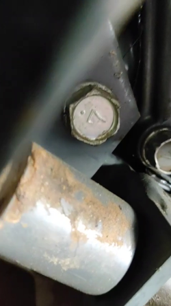

Recently i bought an used Kubota B2650 with about 400 service hours. Always serviced on official shop, and in pretty good overall shape. No strange noises on the first times used at my farm, i thought that all will be fine for the future.
With no reason however, after a few hours of service a noise came from the under of the transmission case when PTO is engaged (more noticeable with engine at idle, with an erratic behavior). No other symptoms, already sent to the shop and analyzed at deep (tractor being open at middle, all transmission components being inspected and nothing that could be identified has being the source of the problem).
This noise however keeps coming whenever PTO is engaged and that's troubling my head...
Another thing i noticed. When PTO is engaged the tractor movment seems like handbrake is always pushed, Doesn't PTO engagment release the PTO brake in these tractors?
Any thoughts or advice is welcome.
