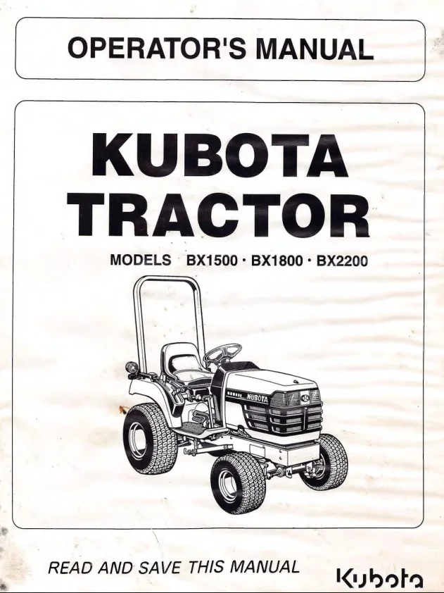

Careful operation is your best insurance against anaccident.Read and understand this manual carefully beforeoperating the tractor.All operators, no matter how much experience they mayhave, should read this and other related manuals beforeoperating the tractor or any implement attached to it. It isthe owner's obligation to instruct all operators in safeoperation.1. BEFORE OPERA TING THE TRACTOR1. Know your equipment and its limitations. Read thisentire manual before attempting to start and operatethe tractor.2. Pay special attention to the danger, warning andcaution labels on the tractor.3. KUBOTA recommends the use of a CAB or Roll OverProtective Structures (ROPS) and seat belt in almostall applications. This combination will reduce the riskof serious injury or death, should the tractor be upset.If the CAB or ROPS is loosened or removed for anyreason, make sure that all parts are reinstalledcorrectly before operating the tractor.Never modify or repair a CAB or ROPS becausewelding, bending, drilling, grinding, or cutting mayweaken the structure.A damaged CAB or ROPS structure must be replaced,not repaired or revised.If any structural member of the CAB or ROPS isdamaged, replace the entire structure at your localKU BOT A Dealer.F-11478A(1) ROPS(2) Seat belt4. Always use the seat belt if the tractor has a CAB orROPS. Do not use the seat belt if there is no CAB orROPS. Check the seat belt regularly and replace iffrayed or damaged5. Do not operate tractor or any implement attached to itwhile under the influence of alcohol, medication,controlled substances or while fatigued.6. Carefully check the vicinity before operating tractor orany implement attached to it. Check for overheadclearance which may interfere with a CAB or ROPS.Do not allow any bystanders around or near tractorduring operation.7. Before allowing other people to use your tractor,explain how to operate and have them read thismanual before operation.8. Never wear loose, torn, or bulky clothing aroundtractor. It may catch on moving parts or controls,leading to the risk of an accident. Use additional safetyitems, e.g. hard hat, safety boots or shoes, eye andhearing protection, gloves, etc., as appropriate orrequired.9. Do not allow passengers to ride on any part of thetractor at anytime. The operator must remain in thetractor seat during operation.10. Check brakes, and other mechanical parts forimproper adjustment and wear. Replace worn ordamaged parts promptly. Check the tightness of allnuts and bolts regularly. (For further details, see"MAINTENANCE" section.)11. Keep your tractor clean. Dirt, grease, and trash buildup may contribute to fires and lead to personal injury.12. Use only implements meeting the specifications listedunder "IMPLEMENT LIMITATIONS" in this manual orimplements approved by KUBOTA.13. Use proper weights on the front or rear of the tractor toreduce the risk of upsets. When using the front loader,put an implement or ballast on the 3-point hitch toimprove stability. Follow the safe operatingprocedures specified in the implement or attachmentmanual.14. Do not modify the tractor. Unauthorized modificationmay affect the function of the tractor, which may resultin personal injury.
