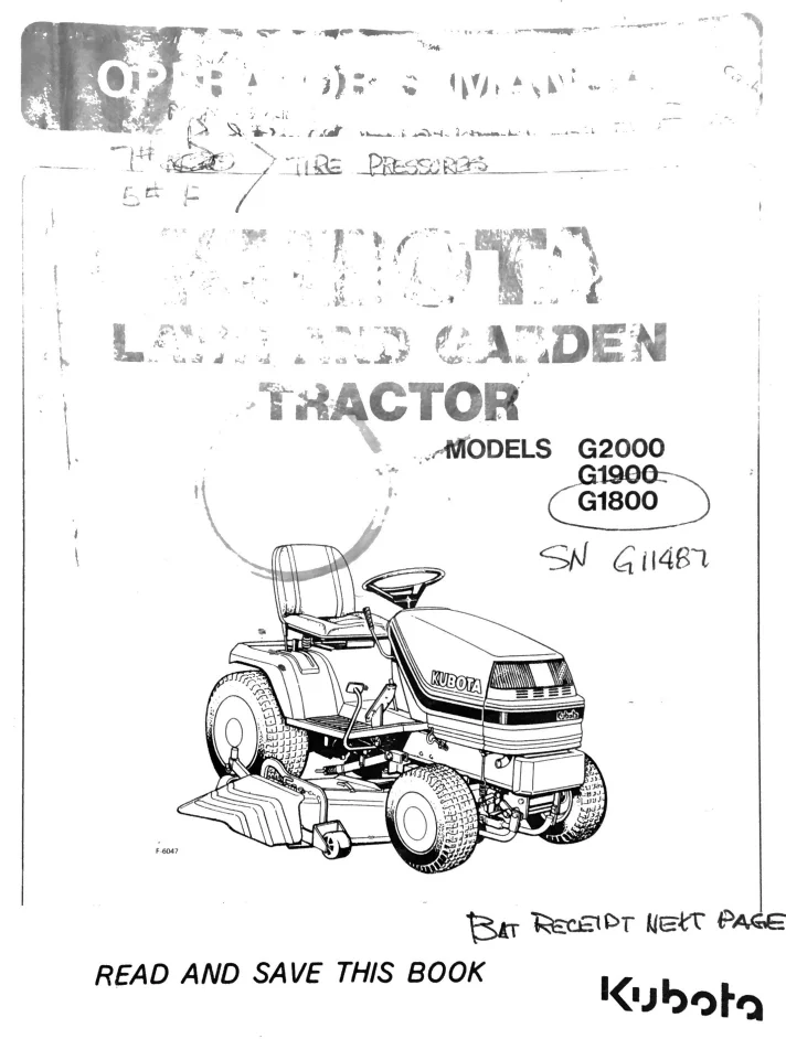

Kubota Lawn and Garden Tractor Models G2000 G1900 G1800 Operator's Manual Code No. 66101 - 6291 - 3 - Instruction Manual
